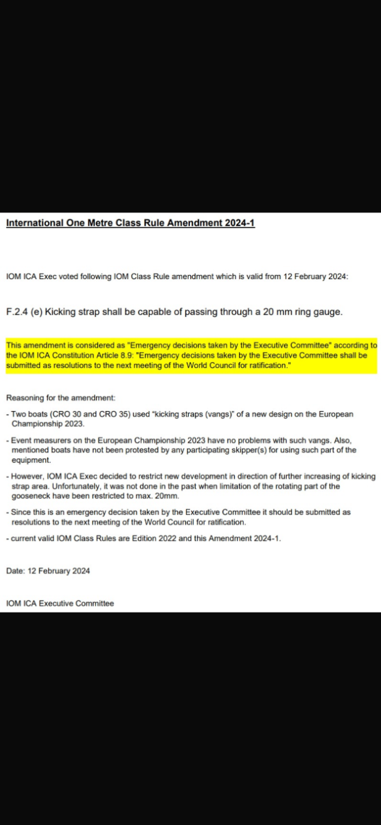

Hello GBR IOM Sailors
I will be adding a poll to gather your votes for two items on the IOMICA AGM. I have attached the supporting documents to this. The vote will end on the 1st November.
1-Ratification of the kicking strap emergency rule issued after the European Championship of 2024.
2-Vote for changes to the CCR concerning Major International Events ( Worlds and Continental championship). management ( status, definition, entries and eligibility)
Ratification of Changes CCR Oct24.pdf

In 2015 Interpretations and rule changes were made by the IOMICA and IRSA Technical committees to define Kicker/Gooseneck Fittings that were deemed to be extending their function by size, providing additional ‘area’ with the potential to add driving force. The introduction of these rules forced a number of commercially available fittings to be altered to stay within class (Potter, AA Parts and others)  See page 28/29. 1.13 2015 Rule Revision
I believe the Emergency ruling being voted on for ratification is not consistent in any way with the reasoning given for the 2015 changes due to there being no length restriction placed on a ‘Kicking Strap’. Essentially as the proposed rule stands, a Kicking Strap of 20mm height could run the full length of the underside of the boom for a considerable gain of ‘additional area’. Can that be right?
Given a very large majority of the class have long used a simple bottle screw/turnbuckle for a Kicking strap, wouldn’t a full length, or even half length plate of 20mm in carbon be considered as extending a function by size if we apply the rules and reasoning quoted in 2015?
Quite simply id suggest any Kicking strap (acting in tension), of a mechanical area larger than a simple bottle screw that overhangs the side of hull or deck is being used for an ‘area’ gain and extending its function by size.
To me the Emergency Rule change on Kicking Straps should not be ratified and a new Rule on Kicking Straps written that applies the same logic and consistency of the one imposed in 2015.

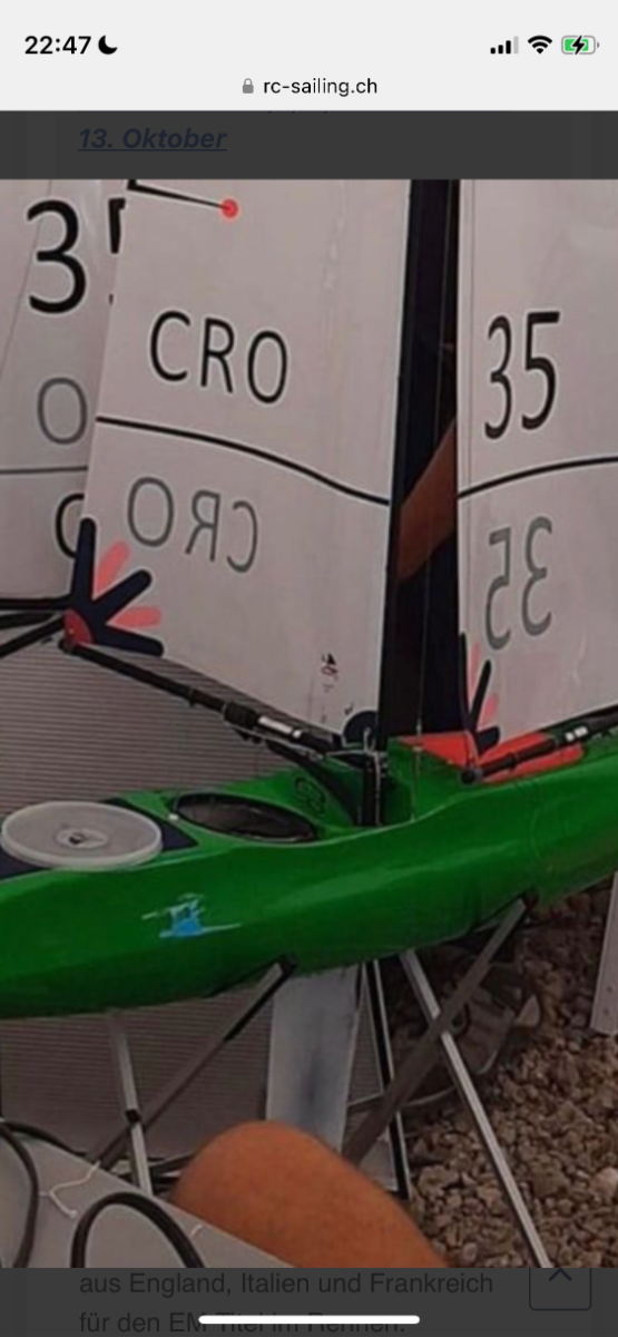

Are there any images of the fitting/concept that required this rule ratification?
I understood that any parts of the rules that a designer/builder has an innovative solution for that may be out of class rule should be checked with IOMICA technical prior to inclusion on a boat.
Therefore this shouldn’t require a rule change as it must be compliant.
Any request for clarification must be recorded somewhere surely and available on request?

A picture speaks a thousand words.
Rule of thumb with almost all modifications is, if it does not state it in the rule then take it as being not allowed.
Not that innovation should be stiffled.

I haven't got a picture of the fitting in question - essentially it was a carbon plate which filled a high proportion of the area between the gooseneck body and the underside of the boom inside of where the kicking strap would normally be.
I received the following from Graham Bantock (MYA Technical Officer) - "I am content that the items used complied with the existing class rules, that failing to restrict the dimension was an omission, and that the 20 mm dimension/method etc is appropriate. " ENDS
It is not clear if the idea was checked before or not by IOMICA, but it is clear the process needs to be changed. However without a GBR representative volunteering to be on the IOMICA technical subcommittee it is hard to put these forward, especially as in reality many go with the idea that unless you get protested then it's acceptable.

I was just watching the A fleet heat of Race 8 at the IOM Worlds. There were a couple of good shots of Zvonko's Viss on the last down wind leg, and the beat to the finish line.
It looked to me that he was using one of these new vangs and it did appear to add extra area on the run, but I think the main reason for it is that it works in conjunction with those big bumps on the after deck. To me it looked like the vang was closing the gap between the boom and the deck near the mast, but it was also closing the gap between the vang/boom and the deck bumps further aft - acting to create an end-plate effect, increasing the efficiency of the rig.
If I am right, then the way to gain any benefit from the new vang would require major deck changes to existing hulls to add bumps.

Hi John,
Interesting observations that i have a different viewpoints on.
I think its important not to cloud the issue with reasons why a kicker of this type has been designed, but to ask how it has been allowed given clear past reasoning for interpretation and rule change in the area of kicker fittings and gooseneck body fitting size and a possible gain in driving force (added effective sail area etc).
It could be taken as an understandable oversight if those making the interpretations and subsequent rule changes on the Potter and similar Gooseneck Body/Kicker Fitting back in 2015 were different personel to those presently holding the position of IOMICA Technical Chairman and the then IRSA Technical Chairman, now MYA Technical Officer.
How do we get two very different viewpoints on what is or is not allowable free area from the same people from 2015 to October 2023? Why was the push for a change to the rules and subsequent banning without modification applied with a clearly pro active way, yet in this new proposed rule a level of dissinterest to apply the same previous logic?
Is anyone truly content that this proposed rule has been well considered? It is one rule for some……

Relating to the Vang issue.
As far as I can tell nobody has mentioned Rule F.2.3
I quote.
F.2.3. states;  THE FUNCTION OF ITEMS SHALL BE LIMITED TO WHAT IS NORMALLY PROVIDED BY ITEMS OF THEIR TYPE.
i.e a Vang only controls the height of a boom.
The Sailboat RC Vang attaches to the boom significantly further aft (40 to 50mm) than required solely to hold the boom down.
Thus allowing the vertical plate element of the Vang to effect air flow under the boom and as such does not comply with F.2.3.
