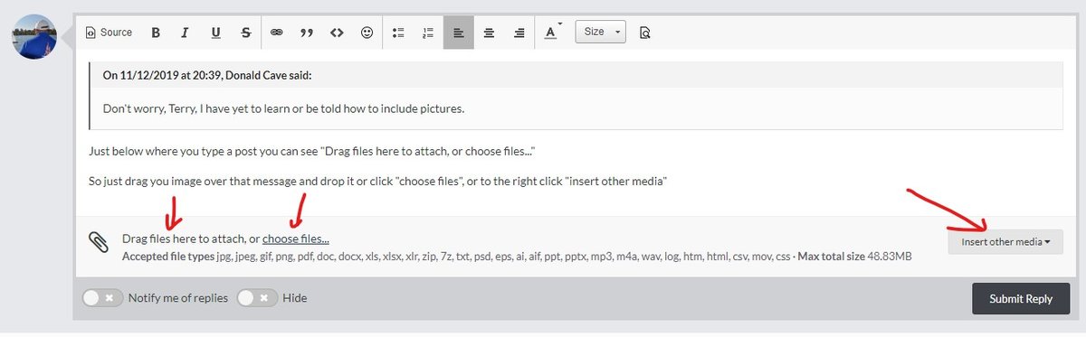

December 13, 20196 yr Administrator On 11/12/2019 at 20:39, Donald Cave said: Don't worry, Terry, I have yet to learn or be told how to include pictures. Just below where you type a post you can see "Drag files here to attach, or choose files..." So just drag you image over that message and drop it or click "choose files", or to the right click "insert other media"
