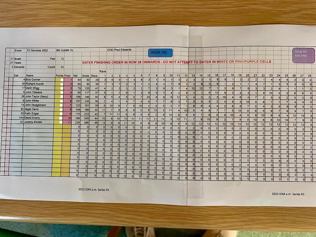

I have followed this thread with interest and although I tend to agree with some of the thoughts and science on the water, I don’t think it is all doom and gloom. I commissioned sometime ago for a Sushi (IOM) to be built. Unfortunately, the end result was the boat ended up over weight by approximately 50 grams with A-Rig fitted. The comparison of how much additional weight is in the IOM is simply a battery pack within the radio pot.
Obviously, it is not ideal and any skipper would rather not have an extra battery pack weighing their IOM down. However, on the positive side, considering wetted surface area, the hull doesn’t sink to much more into the water, less than half a millimetre actually. Plus extra weight will allow the boat to keep the momentum going when other IOMs may have stopped in light wind conditions. We are not talking world beating, highly expensive IOMs here. Over weight IOMs are still competitive in the club and district level. They would also provide a challenge for talented skippers sailing overweight boats against other club members.

Please read my scores from the Joint Services regatta. On the first day (Up to race 11), the wind was barely on the lake and the fleet was drifting for much of the day. Admittedly my scores suffered. However, on the second day the wind gradually increased to a medium to strong A-Rig breeze. Apart from some bad sailing on my part, from race 12 - 27 my scores improved dramatically. Hence it is not all bad to have an over weight IOM as the attached scores prove.
