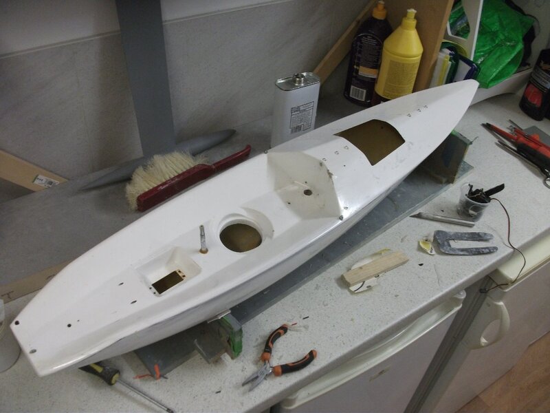

    I have just got this Widget and have stripped it ready for full paint job. Hope to sail it at Poole later in the new year. Hull No 1701 . Looks like it was built by Dave Creed

    Can anybody tell me where to get the plastic hatch covers to fit Vickers V9 models ( in the UK hopefully).

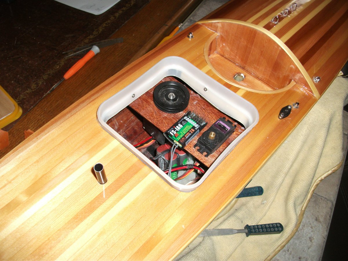

    I will go back to the start of the process but i thought i would send these images of how the winches have been fitted in some of the boats. The key is to keep all the weight on centre where possible You will see examples of a winch being fitted in the centre both vertically and horizontally. I have now gone over to using arm winches mounted under the foredeck. i keep a centre web down the middle of the foredeck for structural strength and appearance. There are many ways of fitting the winches and servos but it is important to keep access easy. The orange boat is a much modified Alternative made of cedar but i did not like the colour of the wood so it got painted ! It has a winch mounted on a shelf fitted just in front of the bulkhead. the final image is the first V8 i made. As you can see the layout is really old school ( copied from my Jazz made many years ago). Some of these ideas have been changed and discarded so they are just ideas of how it has been done in the past.

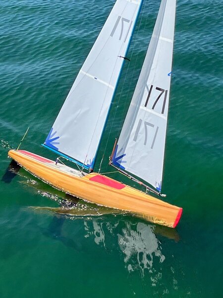

  23. Hi I have built a number of wooden IOMs over the past 2 years and not one of them has been overweight. By using well engineered construction you do not have to put a lot of timber into the hull. A well built woody is very strong, so much of the internal structure needed on a plastic boat is not required. My latest boat was built using Obechi ( usually use Western Red Cedar) for the planking and came out about 240 grams light ( includes A rig and battery). below is an image of the boat and evidence of the weight using my own scale that was checked using the calibrated scales at Gosport.
