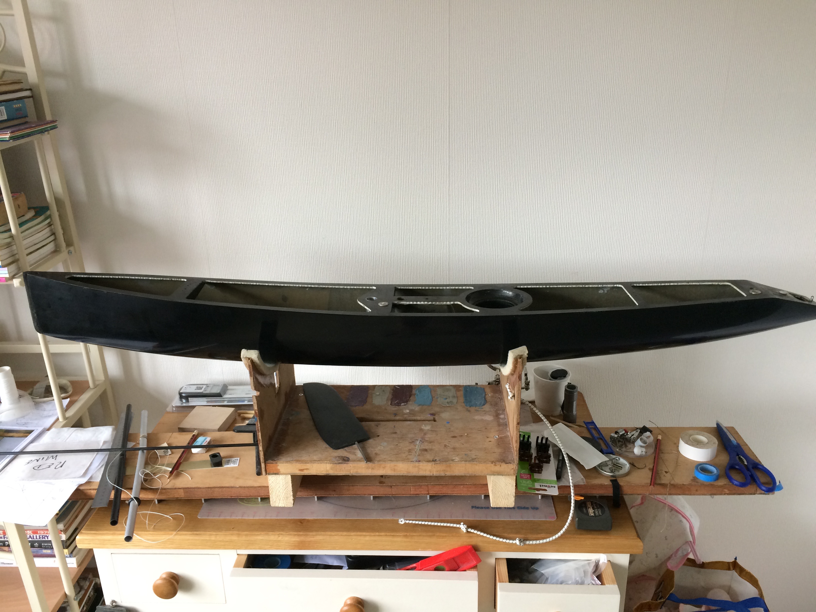

    Stephen, sorry for delay in responding. Boat has been on "back burner" for last few weeks. Everyone has their favourite adhesives. I use the following: SP 106 for structural filleting etc. XCR coating epoxy from Easy Composites for coating. It has built in UV protection. Aliphatic resin from Deluxe adhesive for planking. Easy clean up so all excess can be removed with the usual eye to keep weight off. It sets waterproof. Picture to date. Ready for deck. Richard

    Finished the easy bit last week; planking the hull. Epoxy coated and 50 gsm lined. Weight a constant factor. The peel ply on the inside removed 35 grams of surplus resin! Fiddly bit now: setting up mast / fin box. Richard

    Thanks for the comment Mike. Thinking of a lowered deck aft of the mast to avoid a mast well. I know the current fashion is back to flat aft decks but It is easier, lighter and stiffer for a timber boat than a multi part well or inserting an Ikon or similar moulding. Some more pics of progress. Rough trimmed and sanded hull. Richard
