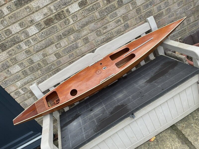

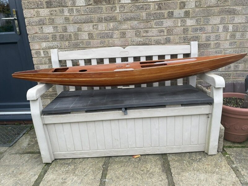

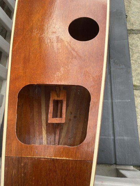

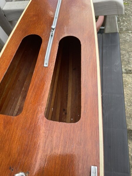

There is interest, just not as much as the more "mainline" classes. I bought this one this year. Have made a start on mast etc . May not be considered strictly vintage, but hey. Will probably end up more as a club/fun sailer, initially with a set of Marblehead sails that I have acquired.
