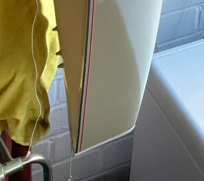

A picture speaks a thousand words. My Alternative with the bung visible on the aft deck to port at the transom.
