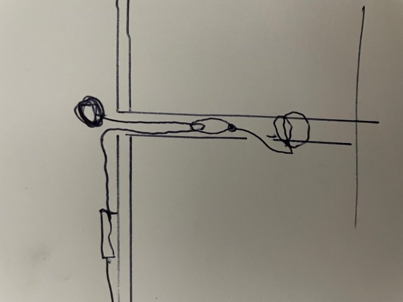

This is how |I fixed it . By feeding a thin wire and pullimh  through a line with a loop inside the tube , this had the Jib line run through the loop.
