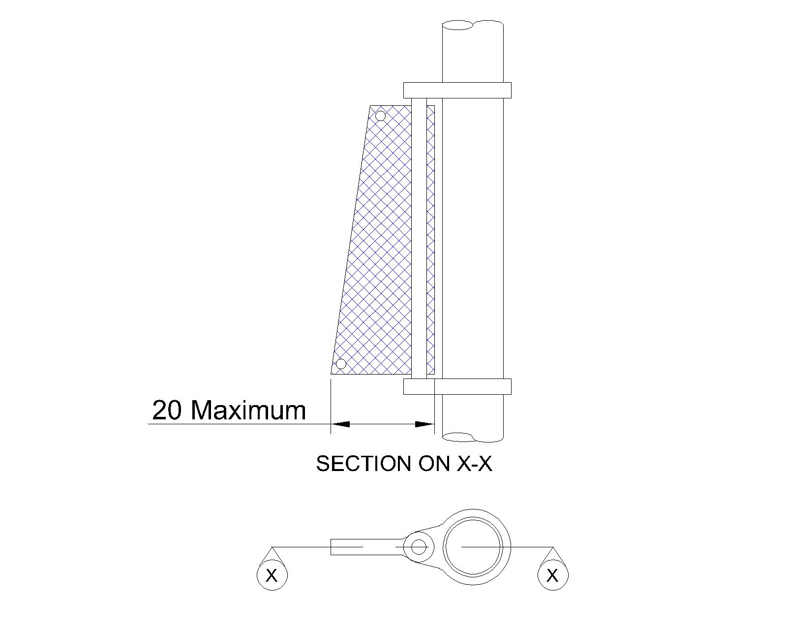

they shall not exceed 20 mm in any cross section perpendicular to the axis of rotation.
Now I would believe that most if not all of the more elegant gooseneck fittings are now Non-compliant and require immediate modification. Certainly at lease three boats I looked at on Sunday were not compliant.
Or am I reading this incorrectly.

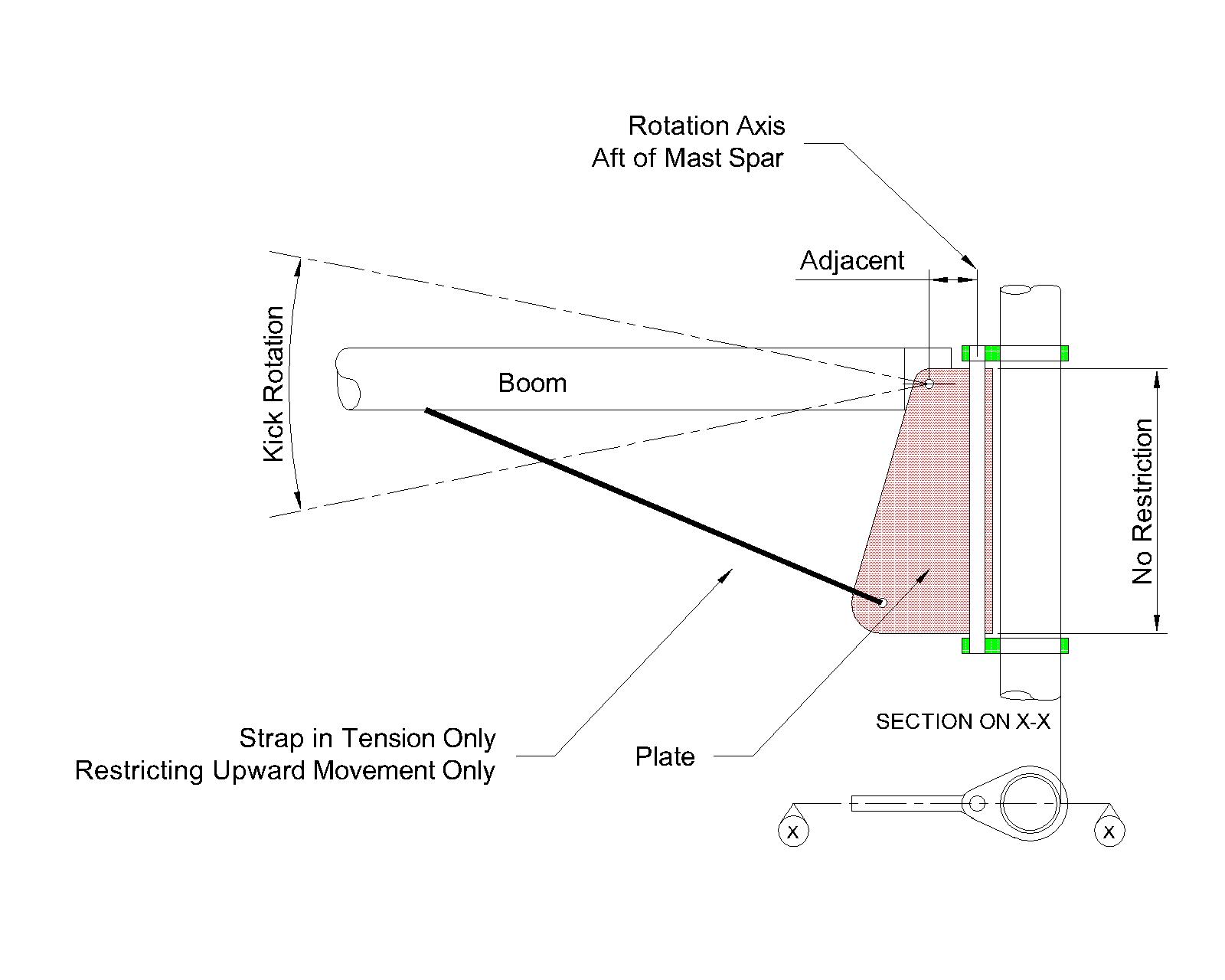

I attach a drawing of the rule as I interpret it.- Tell me I am wrong someone please !
Hi Dave, I am not a measurer but your very clear diagram looks to be correct according to how the rule has been explained to me, regards, John

1. The hinged plate does not provide any structural support to either the Mast or Boom
2. The plate dose combine the both functions of Gooseneck and Kickstrap but certainly does not provide a function that is not permitted in terms of the class rules.

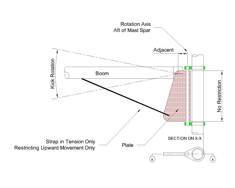

Using the Class Rules as they stood at the time:-
Compliance Test A
F.2.4 (a) Fittings and/or control lines may be combined provided their function is not extended beyond what is permitted.
A1) The plate/ fitting combine the functions of Gooseneck and Kickstrap - YES
A2) The fitting including the plate and any other component part, does NOT provide a FUNCTION that is not permitted in terms of the class rules. -YES
Before we go on to the next Rule let us see if you agree that no part of F.2.4.(a) has been violated.

Remember we are discussing the fitting below NOT the James Christmas .

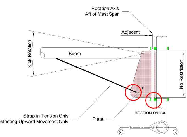

Here are two graphics - a standard fitting, and your diagram. On the standard fitting, the vang attaches directly to the pivot. In your diagram, the vang attaches to the plate and the plate attaches to the pivot.
The ruling said that having the extra fitting (the plate) was non-compliant for two reasons - the added area AND the extra fitting which was not included in the rule.

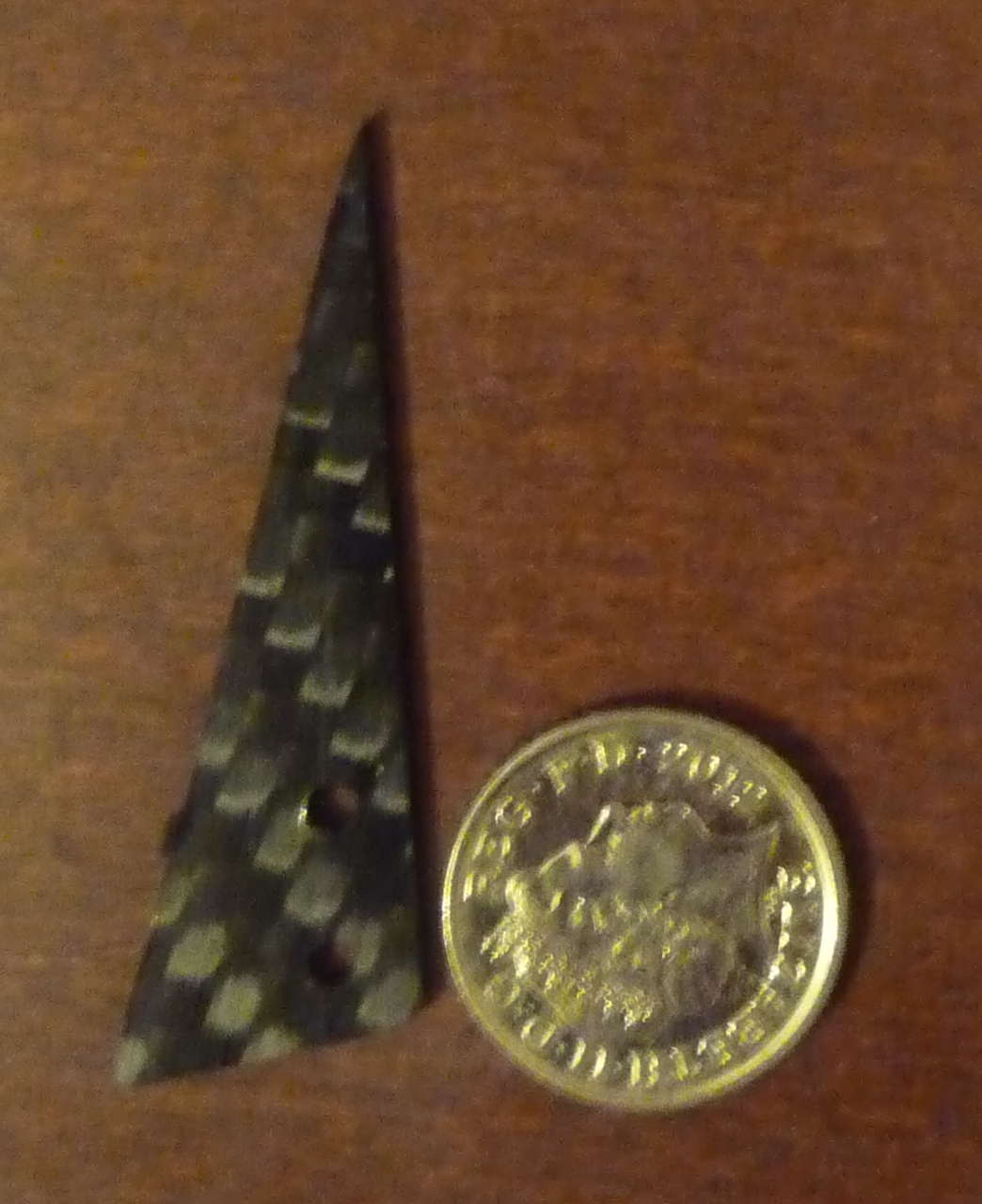

What i have had to cut from fitting to comply compared to UK 5p coin
Bit more thought could have saved a lot of hassle over nothing
