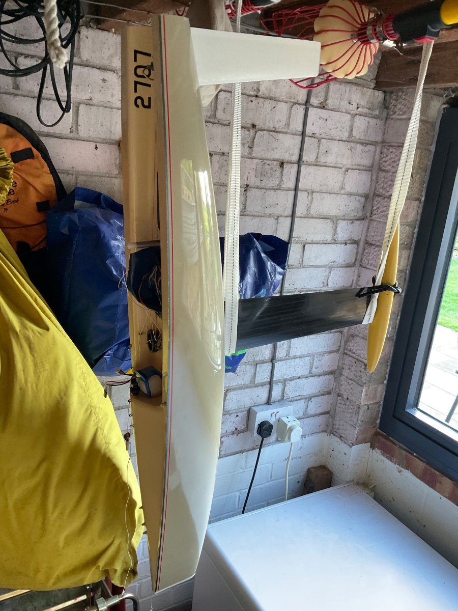

The previous owner of my cockatoo, stored it this way as in the picture, weight of keel and weight held by straps.
and it drains out of the front hole, very well and vents well in between sailing it every other week.
New IOM, Kantun 2, asking for other ideas about storage as it has a rear draining stern hole.
Open to ideas and suggestions
