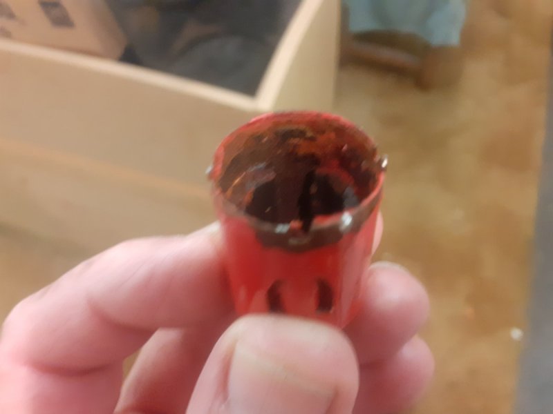

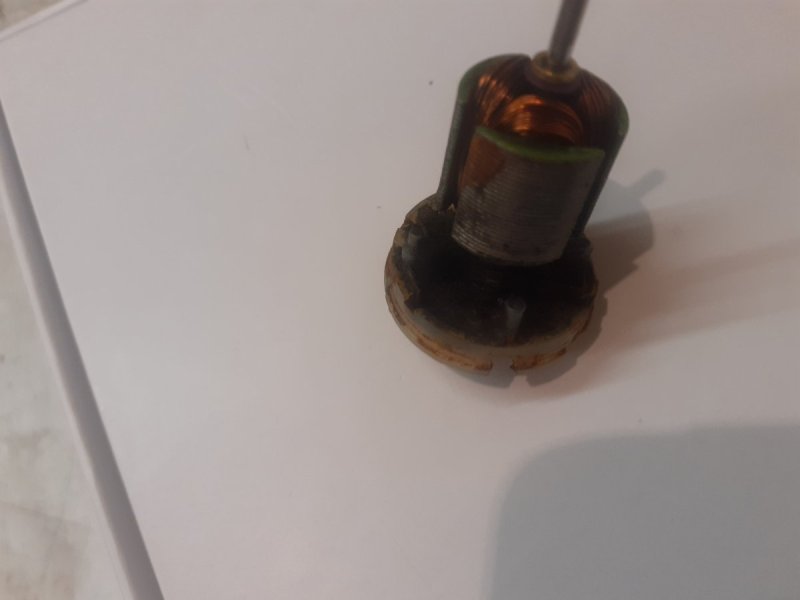

Do you dry your RMG after use?  Well this is what happens if you don't
This one was also showing some pretty severe brush wear
Sorry about the poor images - my phone doesn't do close ups well- but I think you can see the rust on the case and the blackened mess round the commutator.  AFAIK this one had not been used in salt water.
As a result of looking at this one I've changed my view on grease / vaseline i.e. I now think you should definitely not use any.  This one was fairly heavily smothered in vaseline and all the grot and rust had become stuck to it.  There were bits of grot stuck in the gear teeth - not a good plan.
RMGs have their plus points but the exposed design means that they do need to dried and cleaned on a regular basis.  This one appears to have been left in situ for several years (the mounting bracket had to be 'unglued' to get it out).

Actually it has been repaired for the princely sum of £2.42 (plus P&P)

Replaced the motor with this one:
https://www.ebay.co.uk/itm/263001166029
couldn't find a UK supplier for a 2865 but it came in couple of weeks.  Also replaced the suppression capacitors
https://www.ebay.co.uk/itm/303358627684?var=602971242099
I repair RMG winches and have been for the best part of 22 years. The primary issue here is that the patches have not been taken off and the hull allowed to naturally to dry out. An RMG will run underwater, but the motor in particular does not cope well with damp environments and what you have is a prime example of that. Most RMG winches can be repaired economically and as Darin says just like Triggers brush they can go on for years. Just the other day I had an A series winch, circa 1996/7 serial 024 ie one of the very first RMG winches, arrive fir repair and it is back working again with a little TLC. That one is for the shelf.
