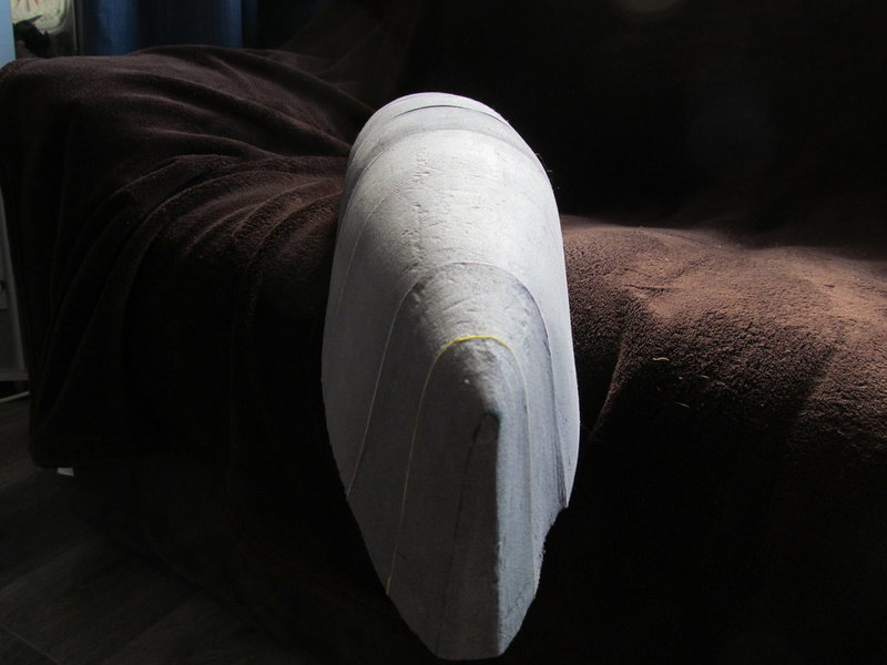

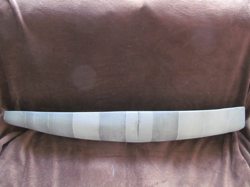

December 8, 20196 yr Disaster avert! Too little epoxy midships ended with the hull in 2 halves, liberal amount of epoxy for the second attempt only to find the mark one eyeball didn't quite have everything aligned as it should (oops!). A cut and shut operation followed with a new 6th section inserted. Now for lots of filler to cover the dents in the foam, bit more sanding then hopefully it'll be ready for a nice coat of glass. A slow burner of a project but I'll get there in the end (hopefully!)
December 8, 20196 yr Hi Shaun, I would just get some glass onto the foam before trying to fair with filler, it will give you a firm even surface to fill and fair. By trying to fill and sand the foam you will only end up sanding more foam from around the patches of filler.

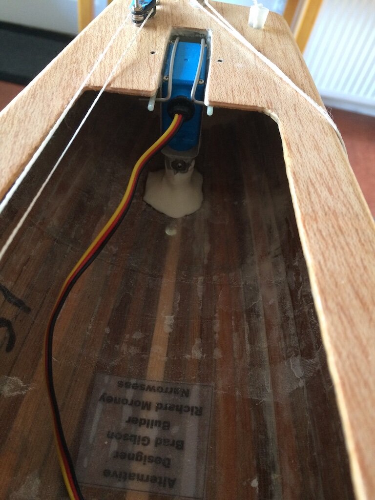

June 24, 20224 yr Author 4 years down the line now and Alternative continues to sail well. Have often been asked about the boat when sailing; seems to be a popular design for home building. The only mod I have made is the fitting of a small Hitec waterproof servo (HS5086 WP) right on the rudder stock. This employs a small moulding made by Dave Creed. See picture for installation. Very effective and, because it is lighter than a typical rudder servo, does not have a negative effect being right on the end of the boat. Absolutely no play because there is no linkage. BUT the achievable angle is greater. Now this is useful when using the rudder as a brake; start line for example. Needs to be allowed for in normal sailing though. Have used this servo completely in the open on Mini 40 trimaran, but lives under the aft deck patch on Alternative. Richard

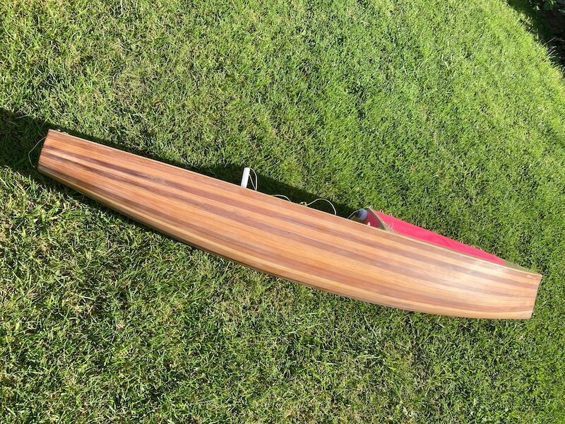

October 17, 20224 yr Author Finally got round to giving my Alternative a refit. Main job was to re coat the hull. Never having been too pleased with the original epoxy finish. Sanded all of with 120 and proceeded to apply 3 coats XCR epoxy, wet on wet. Finishing with 120 dry followed by 400/800/1200 wet to achieve a super slippery finish. The epoxy is extremely hard and also adds strength to the cedar planking. The technicalities of weight are detailed, since these are vital for any one building in wood. Hull finish (epoxy) sanded of with 120. -10grms 3 coats XCR epoxy wet on wet. + 60grms. (20grms / coat) applied with roller Flat back as described above. -30 I have added 20grm to the boat but have a much tougher coating and have been able to sharpen the chines more. Super, super smooth hull. Richard

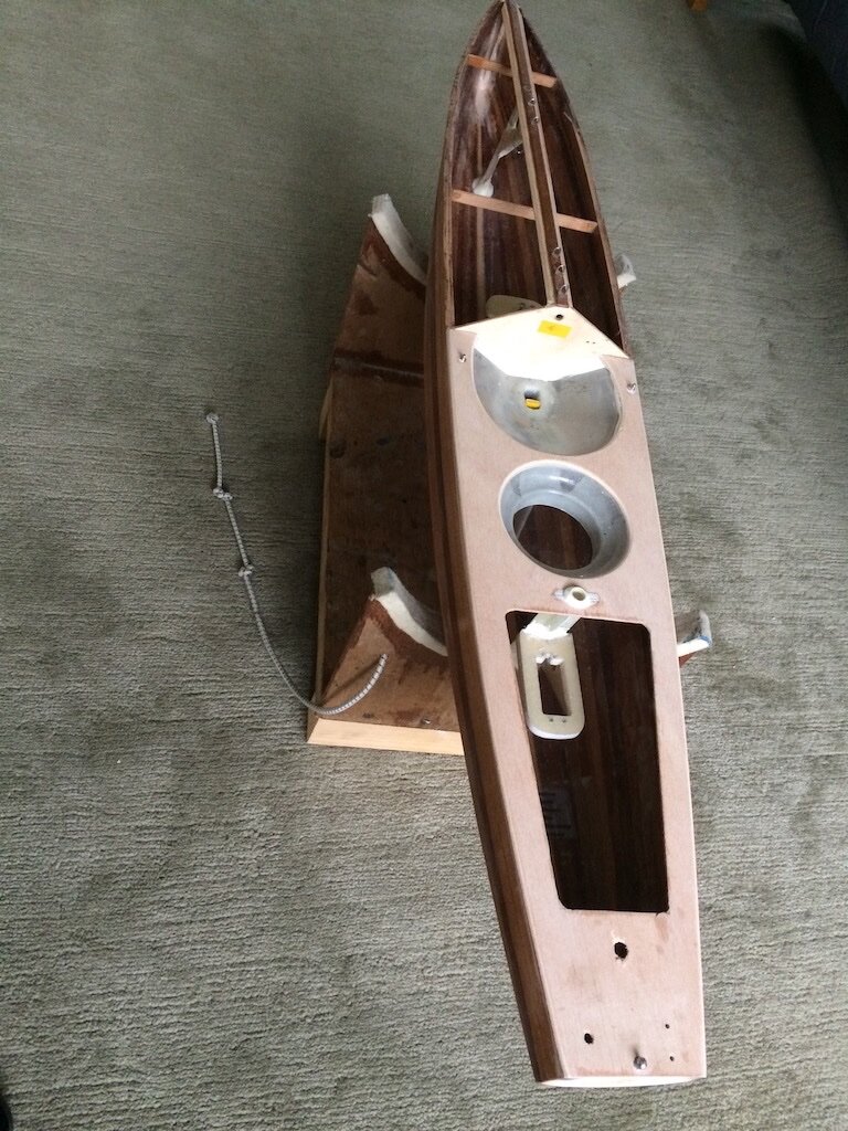

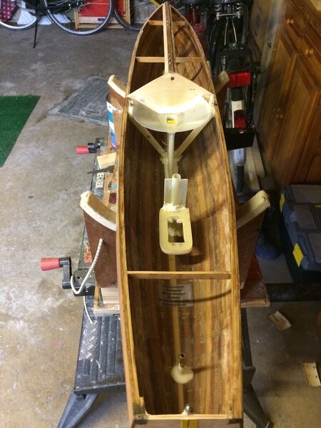

December 20, 20223 yr Author Response to recent request for info on fitting Finbox and well. Pictures show Dave Creed's Finbox bonded to well prior to setting into hull. Then a couple of shots of the assembly. I have tried all wood and also a single all-in moulding; just too heavy. PS. The 3 transverse beams are removed after fitting the deck. Richard Edited December 20, 20223 yr by Richard98 Typo
December 20, 20223 yr Thank you Richard , didn't know DC made moldings like that !! Should save me time in future !!

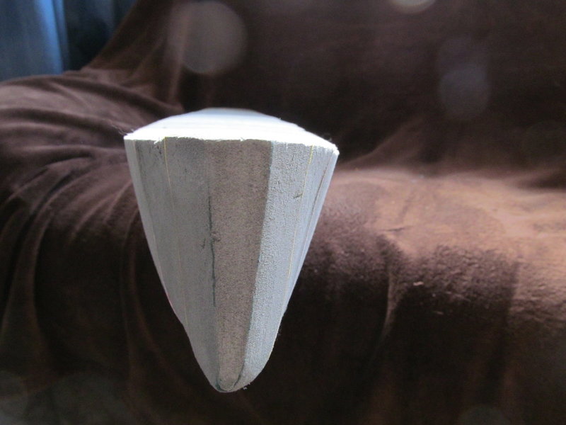

September 11, 20233 yr Author Been asked a few times: what allowance I make for sanding when cutting the shadows / sections. This is one of those questions that answers itself once the "mechanics" are appreciated. Obviously you can sand and sand; removing an unknown amount of material. The reality is that it actually takes care of itself, just like a well set up boat going to windward. The 10mm plank cross section obviously cannot follow the curve of the shadows / stations. The median of the plank is correct and the outsides must be +. Therefore when sanding (with a long board of course) you will, or should, be removing this + only and no more. Therefore what you have is the 3mm plank sitting on the shadows exactly. Keep the questions coming. Richard

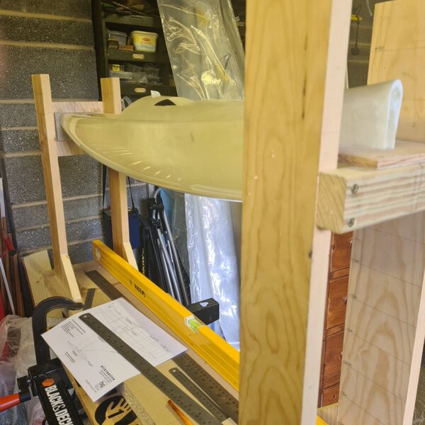

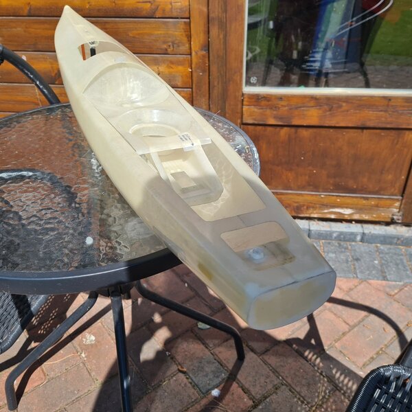

November 16, 20242 yr Richard saw my reference to building an Alternative on another thread and invited me to add my piece. It had been my intention to build a wooden Alternative, but a set of Kris Panis mouldings turned my head. I needed to set the hull up with the fin in the right place etc, so I built a jig. The rest was straightforward. I had the hull sprayed in lacquer by a local car body specialist and I got my sails from Housemartin. Not a lot more to say ..... except that I wished that I hadn't attached the rudder servo mount until after I'd finished with the keelbox. I needed more slender and dextrous fingers than my gnarled old hands have! But I got there. Maiden voyage yesterday with A Rig and happy smiling bunny! I hope she's as fast as my dreams!
November 17, 20242 yr Looks good but I’d say the rig in the photo needs to be much lower in the boat. The same with the other rigs.
November 17, 20242 yr 6 hours ago, Dave Kent said: Looks good but I’d say the rig in the photo needs to be much lower in the boat. The same with the other rigs. Thanks Dave. The rig was lowered by about 7mm subsequent to the photo. This is the maiden voyage with temporary hatch covers.
