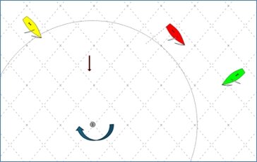

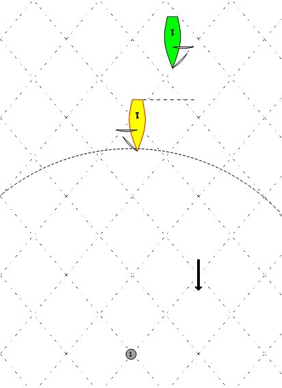

Sorry if this sounds pedantic, but R 18.2 wording changed for the current RRS to remove an anomaly. Under the previous version of the RRS, the boat clear ahead gained mark room, but the new wording says essentially, 'when not overlapped, the boat that reaches the zone first' gains mark room.
The first diagram shows a 'normal' downwind mark with Yellow clear ahead and gains mark room. The second diagram is taken from my web site article on 'Tactical Roundings and Proper Course', See chapter 5 Bonus item, and shows the new wording in action - here we need to assume that the boats are sailing a higher angle that normal, say in lights winds. Here, Green is clear ahead of Yellow yet Yellow gains mark room under the new wording of 18.2, as she reaches the zone first.
