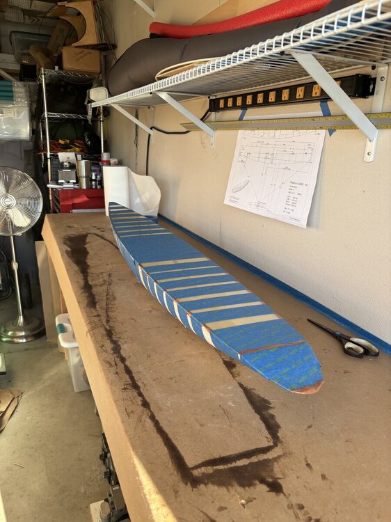

Started on the strongback today. The local FedEx office was able to print the plans and cross-sections for me. Nice attention to detail on Frank's part by adding a 100 mm legend in several places that you can use after printing to verify the scale of the printed pages.
Nothing surprising here. Just cut out the cross-sections and glued them to the 1/4" lite ply in a somewhat material-saving pattern. Hard rolled the paper to make sure the edges stuck down to the wood. Then it was off to the races with the band saw and disc sander. Maybe two hours of work for both of those steps.
Then it was just a matter of aligning them along the center and station lines on the torsion box. It's already starting to look like something.

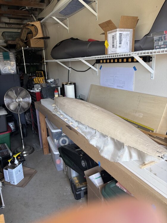

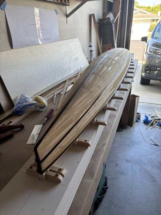

And the rest of the images...
One thing I found useful was to make a set of 'outside' templates. Once you start fairing the mould it's amazing how far out of true you can get, particulalry between stations. If you hold the larger template between stations you can judge the eveness of the gaps. For the last one I made a cradle of outer templates on the strongback to hold the hull true while a put in the keel box etc. The bare shell is very flexible and easy to twist and distort if it is not properly supported
