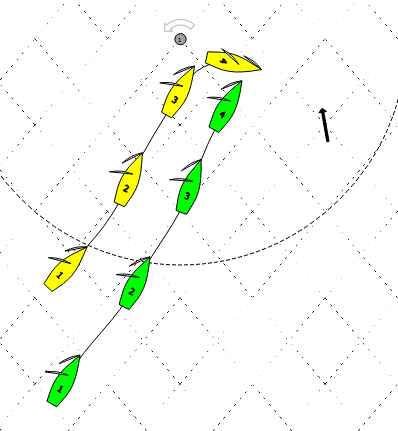

Again Case 60 is not a good precedent for this. If the contact occurred in the zone, then normally, the inside boat is entitled to mark room and the windward/astern boat has to keep clear. However this is more complex as the definition of Room, includes the phrase - in the existing conditions - which suggests give lots of room in gusty planing conditions - but it also requires the ROW boat to be 'seamanlike' - and a bad broach may not fit that part of the definition. However R 21 again exonerates the mark room boat specifically for breaking R 16.
Now looking at the diagram, I think that Windward was giving mark room as required by R 18, and Leeward is not protected under R21 in this case - perhaps Gordon will comment on this.
I did some more reading - Case 75 is very interesting. While not an exact duplicate, there are some interesting implications.
The other rule to consider is R 18.4. As Leeward must gybe to round the mark, R 18.4 may apply. When the leeward boat broaches, does she move further away from the mark? If Yes, then she breaks R 18.4.

On re-reading the description, this is an R 16 situation and Ahead/leeward is ROW and has to allow behind/windward room to stay clear when Leeward suddenly alters course.
My supposition for what it is worth is that the windward boat must be given room and opportunity to keep clear if the windward boat had attempted to miss the broached boat and failed then he is not at fault if no attempt was made then I think he is at fault
It all happened so quickly. One second to react - do I bear away or luff up. Push the control to bear away. Crash.
You should try to avoid as fast as you can react - if you do so and fail to stay clear, then the other boat broke R 16.
The rules don't care which way you turn to avoid - but luffing is usually faster and more effective in these conditions.

If a boat clear ahead changes course in such a way that the boat clear astern is not given rule to keep clear then the clear ahead boat breaks rule 16 and should take a penalty. The keep clear boat must manoeuvre promptly, which includes the time needed by the competitor controlling the boat to analyse the situation. and react accordingly.
