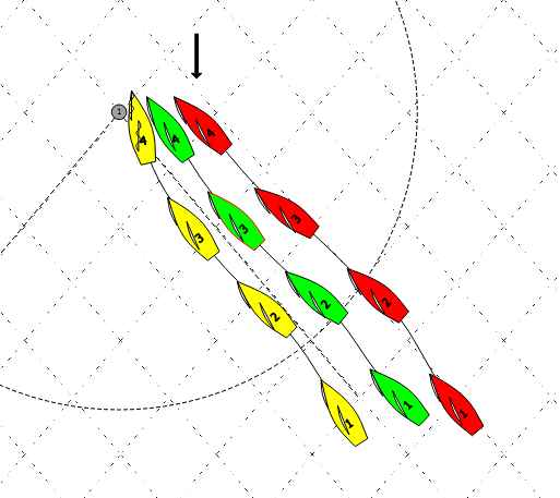

Three boats approaching windward mark line abreast on stbd tack half a boat length between boats.
At ten boat lengths from the mark It is clear that the leeward boat is not going to be able to clear the mark without luffing.

I would not apply Case 60 to this. the diagram is quite different from your description. Case 114 Q1 is much better. Basically, Inside is entitled to mark room, and middle and windward must give room. If there is contact, Inside breaks R 11 and or R 31, but is exonerated by R 21. Middle may be exonerated under R 21 if she was unable to give room because Windward did not give room, and WIndward would be penalised for breaking R 18.2.b.
I would add that yellow should have been calling for mark room and if nessecary before the zone as allowed for in the rules
Thanks for the replies. The diagram is close to the situation re leeward and immediate windward boat (iwb) but the windward boat has pulled out half a boat length and is starting to bear away around the mark and around the bows of the now two stationary boats.It all happened on the far side of the lake. The situation as described all happened so quickly, say three seconds, that the iwb initial reaction was let out sails to stop way to prevent hitting the now bearing away boat whose sail numbers were hidden. The contact made with the leeward boat was made a second or so after the iwb sails were eased.

This is the key to this situation - Windward breaks R 18.2.b. WIndward must wait until the inside mark room boats are clearing the mark. WIndward has to give room to both inside boats, including room for Middle to give room to Inside..
The inside boat does nothing wrong - no hail is required - and as R 18 applies, the obligation is on the outside boats to give room, and the inside boat does not have to give 'room and opportunity' (an obsolete phrase) to the others when she luffs (R 21 exonerates for breach of R 16).
