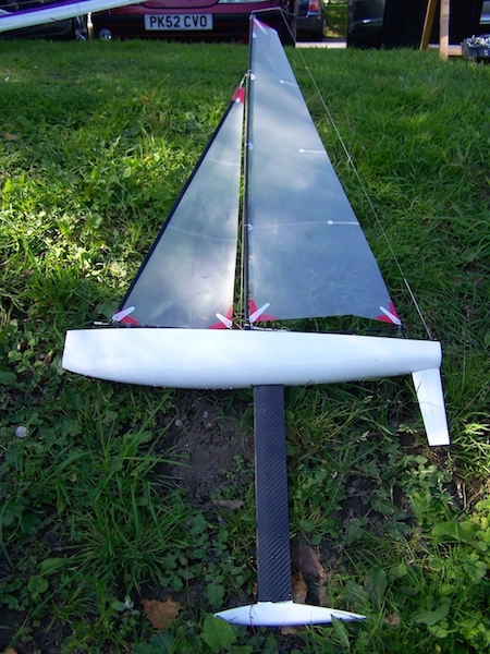

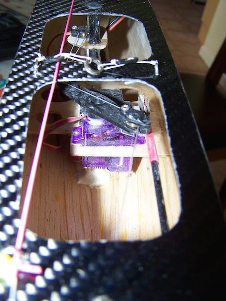

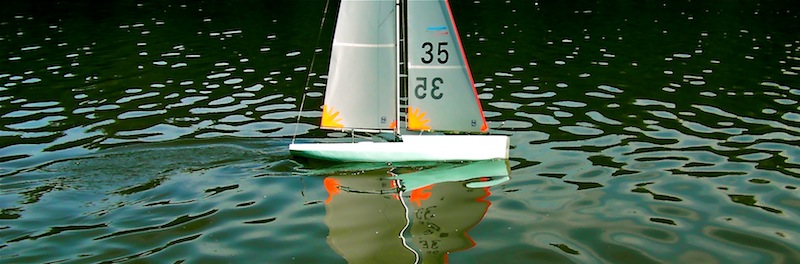

    Yesterday I maidened my first attempt at designing and building and RG65 (Rebel). Her waterline beam is 85mm and her overall weight is 940g encompassing a fin & bulb 555g and current rig 85g. The 55mm width servo arm sail pulley system works fine and the batteries are positioned under the mast feet on the bottom of the hull. The only slight disappointment is that the transom sits a little lower in the water than I would have hoped. Other than that I'm pretty pleased.

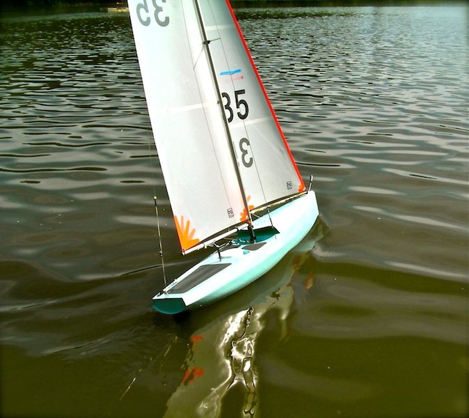

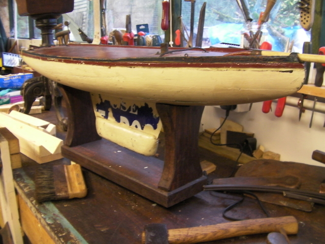

  9. Hi All I visited a friend last Saturday to help identify and to offer some advice. He had recently been left an old pond yacht but there was no rigging or sails. With the help from another forum and VMYC website we now believe the model to be either a 5 Rater or 36R. Due to the skimming dish design and that we think it was built during the late 1800's a 5 Rater is more probable than the 36R which was adopted as a Class in 1929. I have looked but there doesn't appear to be a lot of information about the 5 Rater pond yacht and racing designs on the net. Does anybody have any old photo's or information they would like to share. Our goal is to give this old lady a sympathetic refurbishment so any help would be gratefully received. Many thanks Mk

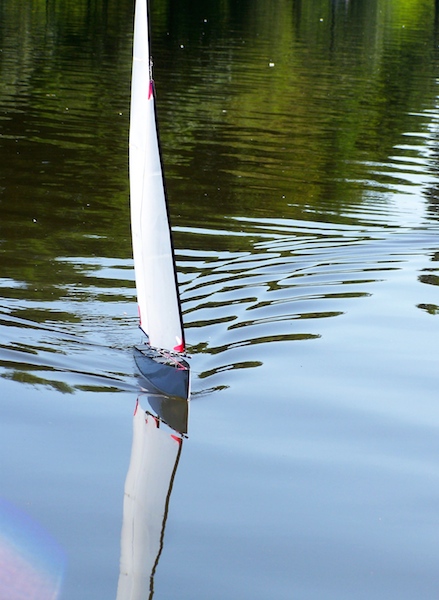

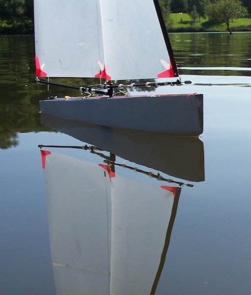

    This is my second completed IOM build of 2014 and my 5th since 2011. With a slight break from tradition I have constructed the hull shell and foredeck from GRP and rear deck from 2mm liteply. I normally adopt a balsa core GRP skinned approach. During the construction I was quite surprised how soft and spongy the all GRP hull was compared to the much stiffer balsa core so I did introduce local reinforcement to the chines and mid-ship, high load areas. The up shot of which produced a hull which was slightly less than a 100g lighter than my normal balsa/GRP builds. I have kept a build log here: http://soaring-sailing.blogspot.co.uk/ Following the maiden you might notice that the corrector weight needs to be fitted further aft Spec: Vertex IOM Titan winch Futaba 3003 rudder servo (for the moment) 2S 1000mAh LiPo 308g A,B & C rigs 230g Corrector weight =1500g + Fin & Bulb = 4kg

  12. Thanks John Any homebuilt IOM which requires corrector weight is a success in my book and the amount used depends a lot on the winch and batteries. However, glues and resins weigh more than balsa so being clean and careful pays dividends. Here is the link to my building log antics: http://soaring-sailing.blogspot.co.uk/ And just a couple more photo's as I'm like a proud father at the moment.
