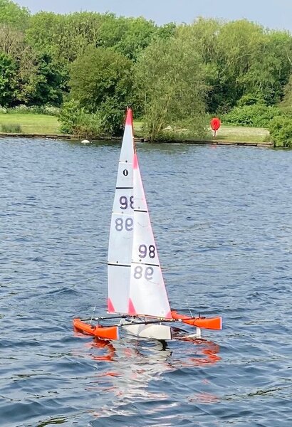

  7. Richard98 posted a topic in IOM
    Been playing around with multihulls for some time now; various configurations of cats and tri's. Here is latest effort and was intended to use an old One Metre hull with a "bolt on" conversion to a lightweight trimaran. Not a new idea, I know. Paul Goddard has an excellent version based on the DF95. Anyway, a few pics of what can be achieved with simply printed floats and a few printed brackets. Boat can be sailed conventionally as a One Metre: remove the fin and ballast, clip on the hulls, connect the longer rudder and just sail as a trimaran (will need a stub fin as a centreboard) Or add foils to the outboard brackets and try foiling. This is Mini40 legal but a bit shorter than the max allowed and a tad more convenient. Weighs in at just under 2Kg all up sailing weight. I have not sanded the printed floats and they are printed in 4 parts. This set was assembled with thickened epoxy, hence the visible joints. I have printed another pair and joined with clear epoxy and will retro fit these after fully testing. I do not intend to have this measured or propose any "minor" rule amendments to make this legal. Just a good way to use an old IOM hull and have some fun.
