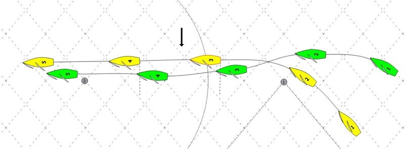

June 18, 20251 yr Hi Roger and Colin, I have created a diagram that I think represents your question. As drawn, Green obtains an overlap from astern and this meets the description for R 17 to apply. So yes, Green must bear away to her proper course to the next mark which is dead down wind as soon as she has passed the offset mark. Green established an overlap before Yellow touched the zone, and is entitled to mark room, which was given. John Edited June 18, 20251 yr by John Ball added name

June 18, 20251 yr Author Hi John, thankyou so much for your time and the schematic explanation. That is exactly what occurred. To clarify and avoid any confusion, could you confirm that the proper course for the green boat, is to bear away onto a run, or very close to it, after rounding mark 2
June 18, 20251 yr Hi Roger, As R 17 apples, Green is obligated to not sail above her proper course. Proper course is subjective, but bearing away to a downwind course of some type is reasonable. Holding on to the reach or going higher does not seem reasonable. As Leeward boat, Green's proper course is what counts - but it must be defensible in a protest hearing. John
