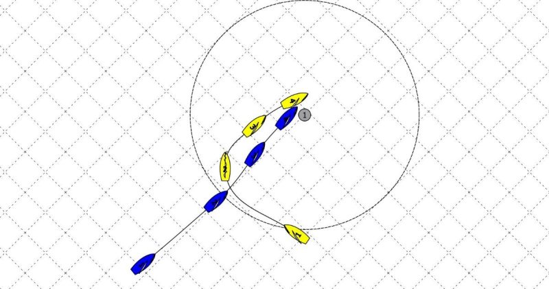

August 2, 20233 yr We used a set of videos as a rules teach-in recently including this one: Thanks to this and Nigel B's scenarios, I think I understand the rules if you tack in the zone on a Port hand mark i.e. 1) You are not allowed to make a boat to windward of you sail above close hauled. 2) If you get overlapped inside, you must give mark room (even if the overlap occurs within the zone). See second part of video. When this video was made the rules applied equally to port and starboard marks (see comments on the video), but Rule 18.3 now only applies to " a mark to be left to port". So what are the rules for a starboard hand mark? Taking 1) first. The first part of 18.3 is a restriction on a right of way yacht (* 1). So if this restriction does not apply to a Starboard hand mark the presumably the tacking yacht can force the windward yacht above close hauled? (but she must allow windward room to keep clear see *1). So the tacker has more rights on a Starboard hand mark? The second part is less clear to me. 18.3 doesn't apply. 18.2 d says 18.2 b & c no longer apply if the boat entitled to mark room passes head to wind (the tacking yacht definitely had an overlap before she tacked) . So that leaves 18.2 a, e & f. 18.2 a says the outside boat must give the inside boat room - Note there is no mention of when the overlap occurs or the zone. In 18.2 e, the meaning of 'in time' is not clear to me in this situation but if it is clear that the inside boat did gain an overlap before the mark then this doesn't apply. 18.2 f says that the tacking boat must be given time to give mark room. So my conclusion is that this situation is that 2) is the same as for a Port hand mark. Is that correct? An example below. 1) Yellow enters the zone on starboard and will cross ahead of blue. 2) Yellow tacks in the zone and slows. 3) Blue gains an inside overlap. 4)Yellow does not give mark room and there is a collision. Yellow is at fault? *1 The boat that has tacked in the zone is to leeward and therefore has windward leeward rights, but must allow the windward yacht room to keep clear as she gained these rights following a tack.
August 2, 20233 yr My answer is that as drawn, Yellow is at fault for failing to give mark room to Blue under R18.2(a). As this is 'marks to stbd', 18.3 does not apply - and in the absence of 18.3, 18.2(a) applies when the boats become overlapped in the zone. I cover this on my web site https://sites.google.com/site/johnsrcsailingrulesandtactics/ See Chapter 3 Bonus - Weather Mark - the 'dreaded' Marks to Stbd and see Pg 4 John
