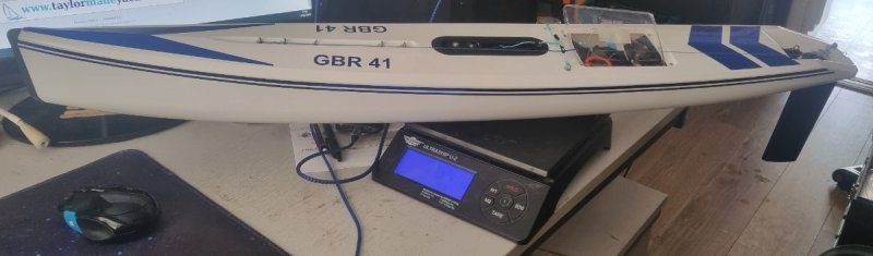

Jim La Roche Posted March 15, 2023 Posted March 15, 2023 (edited) Hi Richard, Here's a 65 @348g. I don't have a bare 95 but mine weighs 754g. The winch, servo, receiver & rudder are approx. 140g. of that. Edited March 15, 2023 by Jim La Roche
Richard98 Posted March 15, 2023 Author Posted March 15, 2023 Many thanks Jim, The DF65 is not far off the weight I am looking for. The 95 is quite heavy. Will place a wanted for an old DF65 hull; even a broken one would do. Richard
