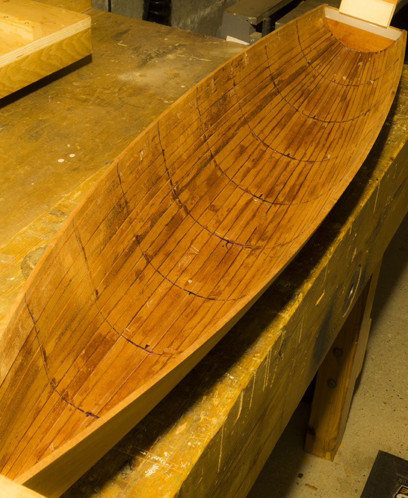

ericatcse Posted December 8, 2017 Posted December 8, 2017 looks really good what glue did you use whilst planking? I hope to start building an Ellipsis IOM soon , have bought the planks just staring to get the other stuff together. I have already bought another boat with good rigs etc which I will transfer in due course. Do you have any more pictures to illustrate the planking process?Cheers Steve

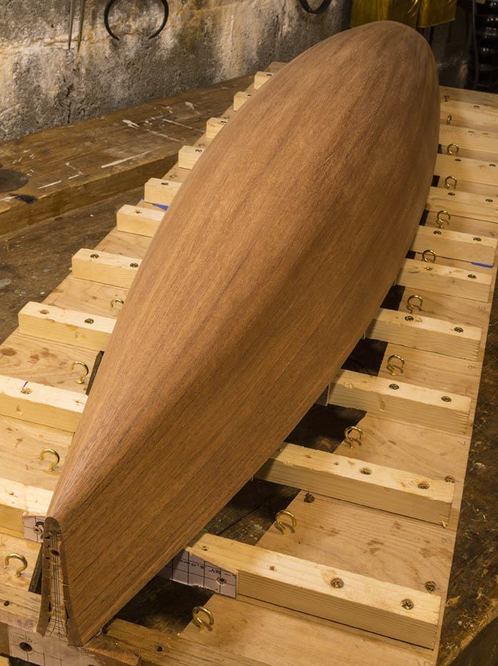

grahamcameronhimself Posted December 9, 2017 Author Posted December 9, 2017 This is all glued with West System Epoxy. I hacked up a lump of an old mahogany table to make the planks. Had to restart after putting a couple of planks on too carelessly. My innovation (probably thought of by many before) was to cut out the building board so that I could get inside as I was building. I suspect the boat will be too heavy to be competitive. The most difficult bit was the fitting of the planks around the foot of the stem/bow. I planed the planks to shape in pairs clipped together and then planed the bevels to get them to fit. Have now bought a second hand boat to learn from and for organ transplants.

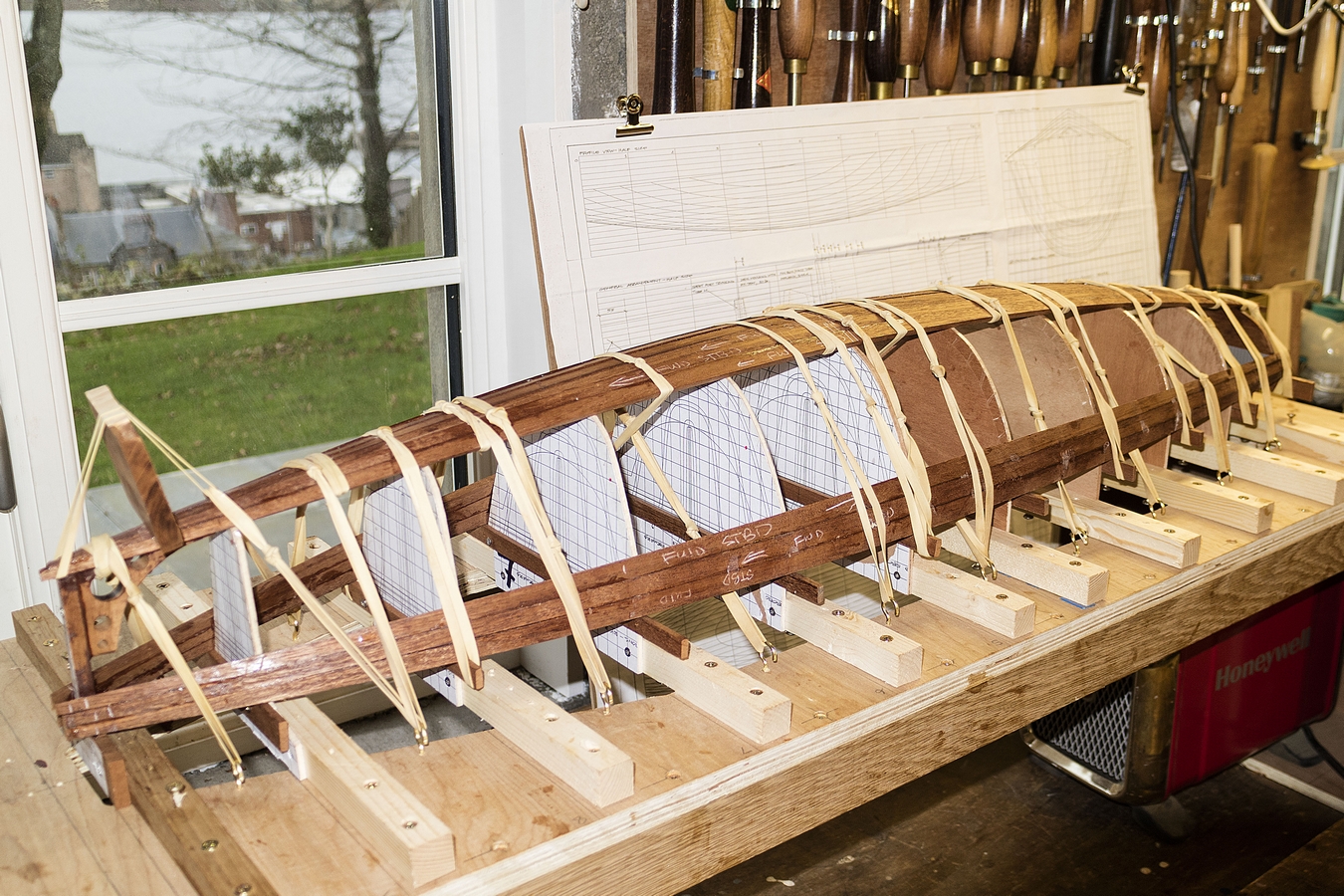

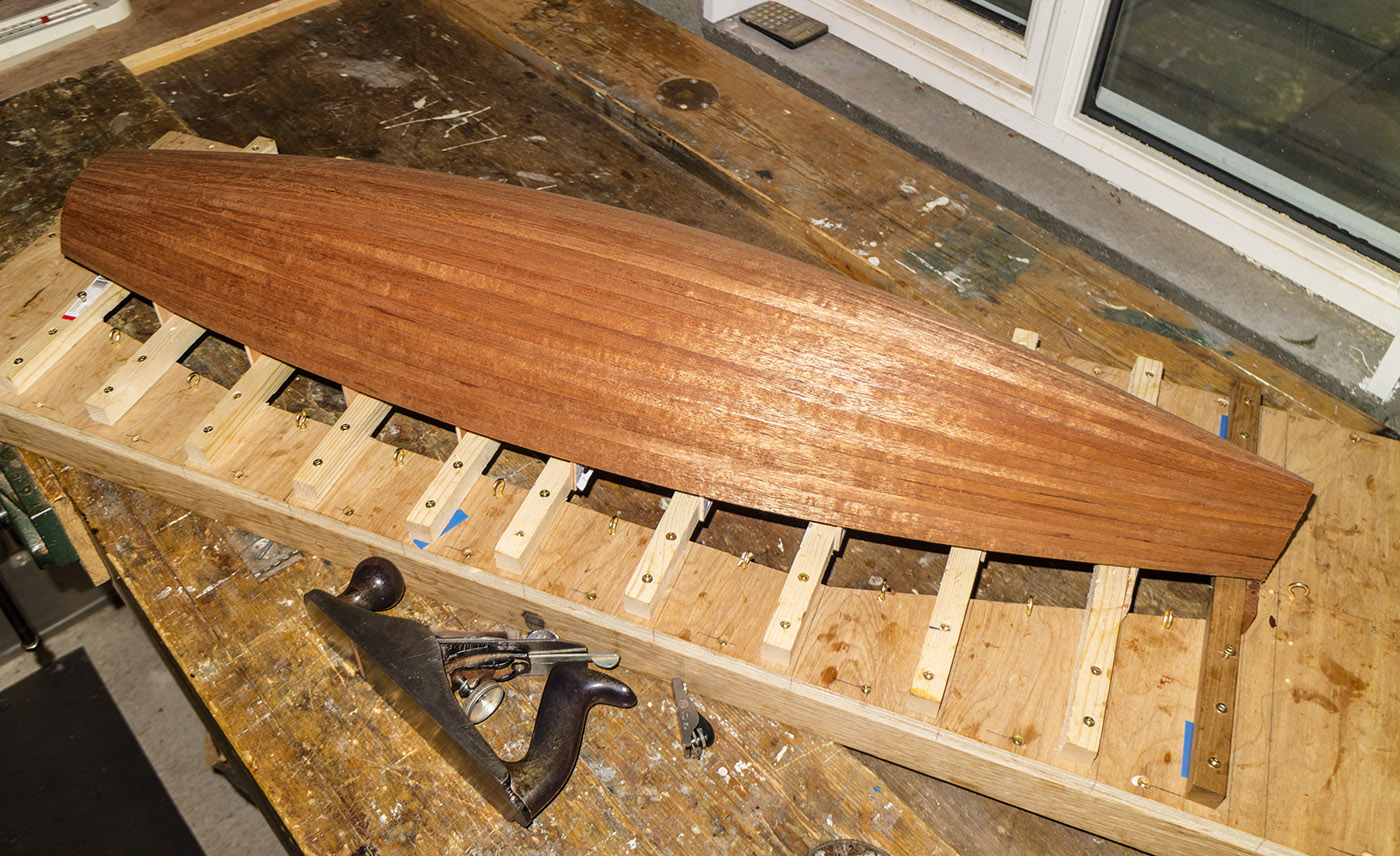

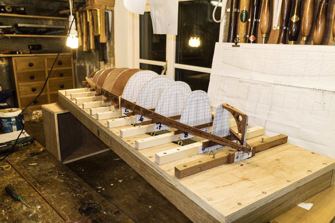

grahamcameronhimself Posted December 10, 2017 Author Posted December 10, 2017 Other tips - though as a beginner I have a nerve giving tips. (1) Before mounting the shadows I cut a tiny sawcut in the bottom of each at the centre. I then strung a bit of fishing nylon along the notches so that I could sight along it for straightness. (2) In the first two pictures you'll see protruding bits of plank that I fixed to the shadows at deck level. This meant that I had no difficulty in positioning the top plank, and also gave options for hooking my elastic bands to hold planks with drying glue. NB you can haul the planks down pretty tight at the shadows, but be careful between the shadows that you don't pull them out of shape if you bind them there. (3) Once you have planed the planks to fit you bevel the edges to accommodate the curvature. If you take too much off you can spoil the overall shape you carefully created. Cross hatch the edge being bevelled with pencil strokes. You can then bevel but ensure that you never quite remove the pencil marks - there should be a dot from the line left at the outside edge. By the way, in the picture which includes my plane, a casual observer might not notice that there are two planes. A tiny one and a big one. The tiny one was well used in my method (and cost three times as much as the big one!)
