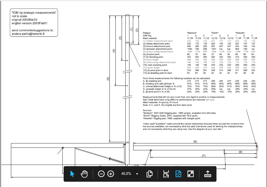

I have bought a one metre rig kit and have found measurements for it.is there somewhere I can find measurements with diagrams and illustrations with the measurements.thanks

On a roll, have a look at the downloadable documents here:-
www.aa-parts.com/en/  (sorry could not get hyperlink to work)
Gives a lot of information as well as a range of drilling for masts, varying shroud and spreader heights etc.
Hope of use to you & not overload of info.
