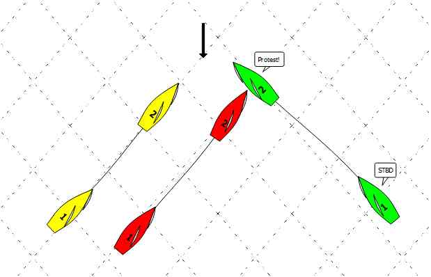

I think this diagram represents your incident.
Green is on Stbd and has ROW (R 10) over Yellow and Red.
Yellow on port, is windward of and must keep clear of Red, also on port under R 11.
As Red and Yellow approach an obstruction, under R 19, it is up to Red, as ROW over Yellow, to decide how to pass Green, the obstruction. If Red decides to tack, she will hail for room to tack under R 20, and Yellow must comply as outlined in R 20.
However if Red does not hail for room to tack, her other option under R 19, is to pass astern of Green, and in so doing, must also leave room fro Yellow to pass astern of Green.
This is discussed in ISAF Case 11 - When boats are overlapped at an obstruction, including an obstruction that is a right-of-way boat, the outside boat must give the inside boat room to pass between her and the obstruction.
In the final summary of Case 11, it says -
PW was not required to ‘tack into open water to windward to keep clear’ because PL did not hail under rule 20.1 for room to tack and avoid S.
So Yellow did not do anything wrong, and Red is at fault under R10 for hitting Green, and R 19.2.b for failing to provide room for Yellow to pass astern of Green.

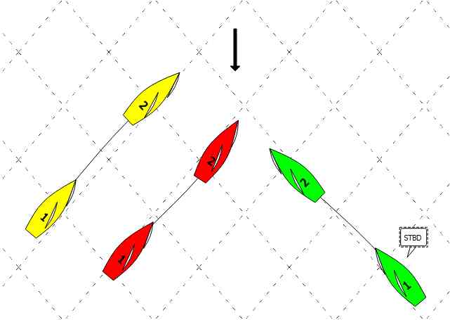

John,
The situation was a little different from your diagram in that Yellow was alongside Red and Green was not on a course to pass ahead of Red. In my opinion Green, after hailing "Starboard", should have passed astern of the Green Yellow pair and protested.Not to hold his course right up to the point of collision.If he had hailed earlier, Green would have asked Yellow for room to tack which would have put Red right astern of Green. Red could then have tacked on to port and sailed safely away, or he could have stayed on Starboard until he reached the lay line and then tacked on to port.Only when he tacked would both Green then Yellow be able to tack on to port,well above the lay line.
Here is a revised diagram. However it does not change the discussion. Under R 19, Red gets to choose which side of Green to pass. At P1, Red must do something. By P2 it is too late. If Red chooses to tack, she has to hail for room to tack using R 20. But by not hailing for room to tack, she is making an implicit decision to pass astern of Green, and must give room to Yellow to also pass astern of Green. But from your description - she did nothing - she sailed straight on and collided with Green.
Green, on stbd is not obliged to do anything, except under R 14 - try to avoid a collision - but Green will be exonerated under R 14 provided there is no damage.
Red is still at fault (R10 and R 19.2.b), and Yellow broke no rule.
