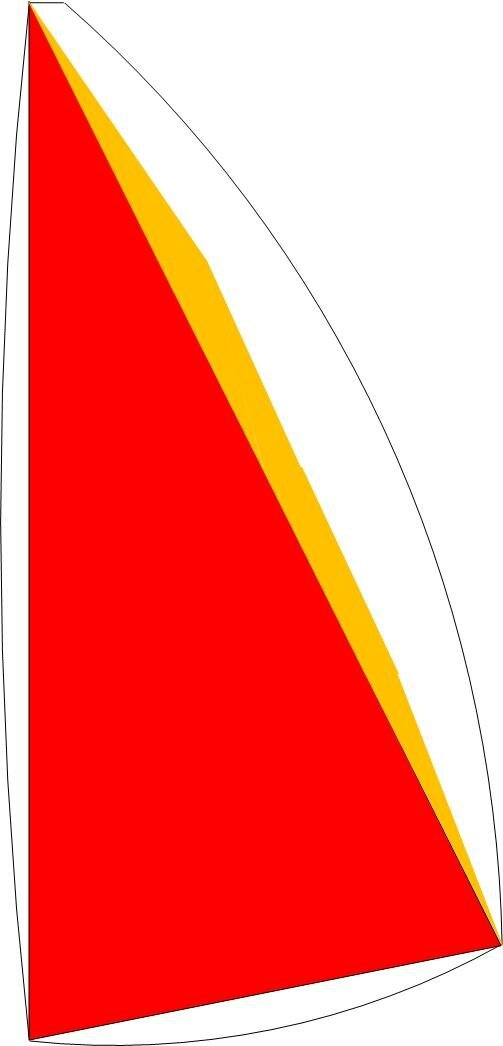

We all know that a Marblehead has a maximum sail area of 516100 mm2.  Well it does and it doesn’t.  It is true that the ‘certified’ sail area of a Marblehead is 516100 mm2 but, thanks to the rather arcane way in which the sail area is measured, the actual plan projected area is about 40% bigger than the quoted figure (assuming I’ve got my maths right).   To put it another way, if you were to measure a set of Marblehead sails using the 10R rules, then the answer you would get would be about 722500 mm2 (which goes some way to explaining why 10Rs don’t beat Ms as easily as you might first think they should). The attached sketch explains why.
For a mainsail (jibs are similar), the red area is measured as a triangle defined by the length of the luff and the perpendicular foot length (A and B in the measurement rules).  If the cross-widths exceed a given limit then the orange area is also measured, however the white areas are always ‘free’ and account for a significant area of the sail.
