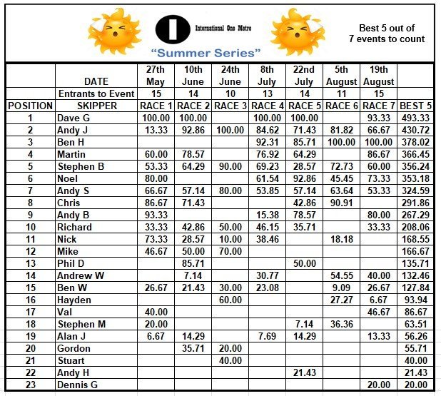

I use a fairly simple to use spread sheet, which presents the results as per below, happy to share this with you

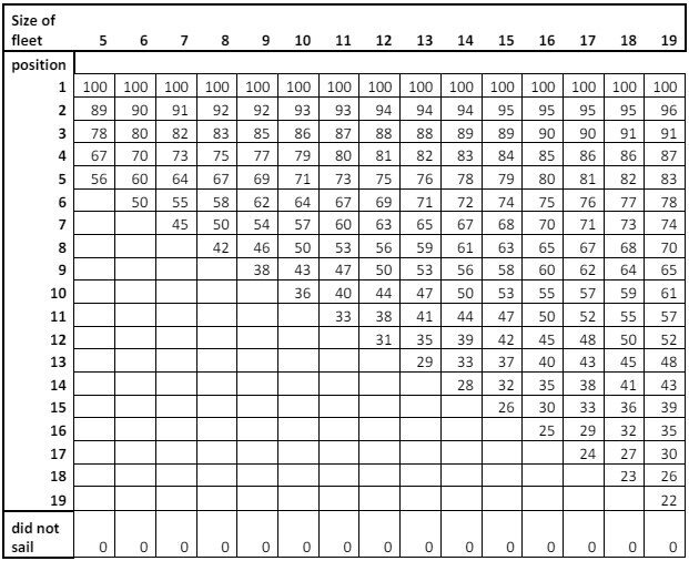

Late to the thread lol, but LRSC have been using this method since Autumn '22. (With of course a number of discards, set by the number of rounds in the series).
As others mention, a series over 6 months is different to one over a few days (where all entrants are likely to be there 100%), so 'DNC' is a bit simplistic IMHO - especially at Club level.
There's a formula we use for it in Excel, but to show it pictorially:

On the method that LRSC uses? (Which looks approx similar maths as Andrew's) Am trying to pick out an example like that, but coming at it from the other end for example 4th out of 10 scores higher than 4th out of 5, which is harder=rewarded?
