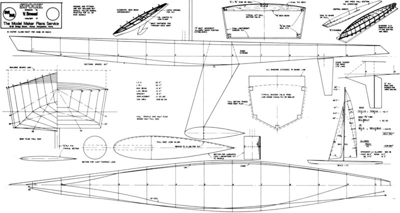

Eric,
The full sized plan may still be available from Sarik Hobbies but I could not see it on their website so you might need to contact them and check if its in their archive.
There is a reasonably high resolution copy of the plan on the excellent All Radio Sailboats website  https://www.allradiosailboats.com/img/boat/s/spook/Spook-Feb-81.jpg
The plan says the full sized lead is 16 lb but reduce it to 15 lb for radio control.
The distance from the deck to top of the mast is 80 inches.
There is an article on the design in the February 1981 issue of Model Boats magazine, probably available via Ebay.

on the ‘Spook’ front, I have turned up a counterweight pattern from which I will make a mound and case the lead.
then I will have to decide whether to make the fin or the weight removable for transport. Any experience of retro-fitting a keel box would be useful
